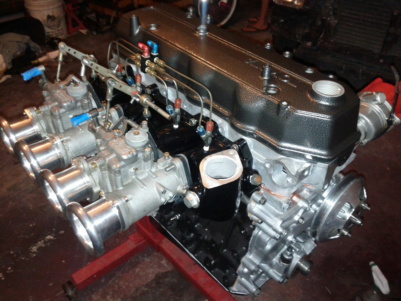

2.6L Stroker with Dual Mikuni Solex 50's and 150 shot of NOS
monster of all 22r motors 2.6L 22r Stroker dual mikuni solex 50 carbs, 150 shot nos, 12.5 to 1 comp CP forged pistons, custom forged made light wieght rods with tsgte bearing journals, stroker crank, custom grind schnieder 530 lift cam int & ex, race prepped head over sized valves..lot more
