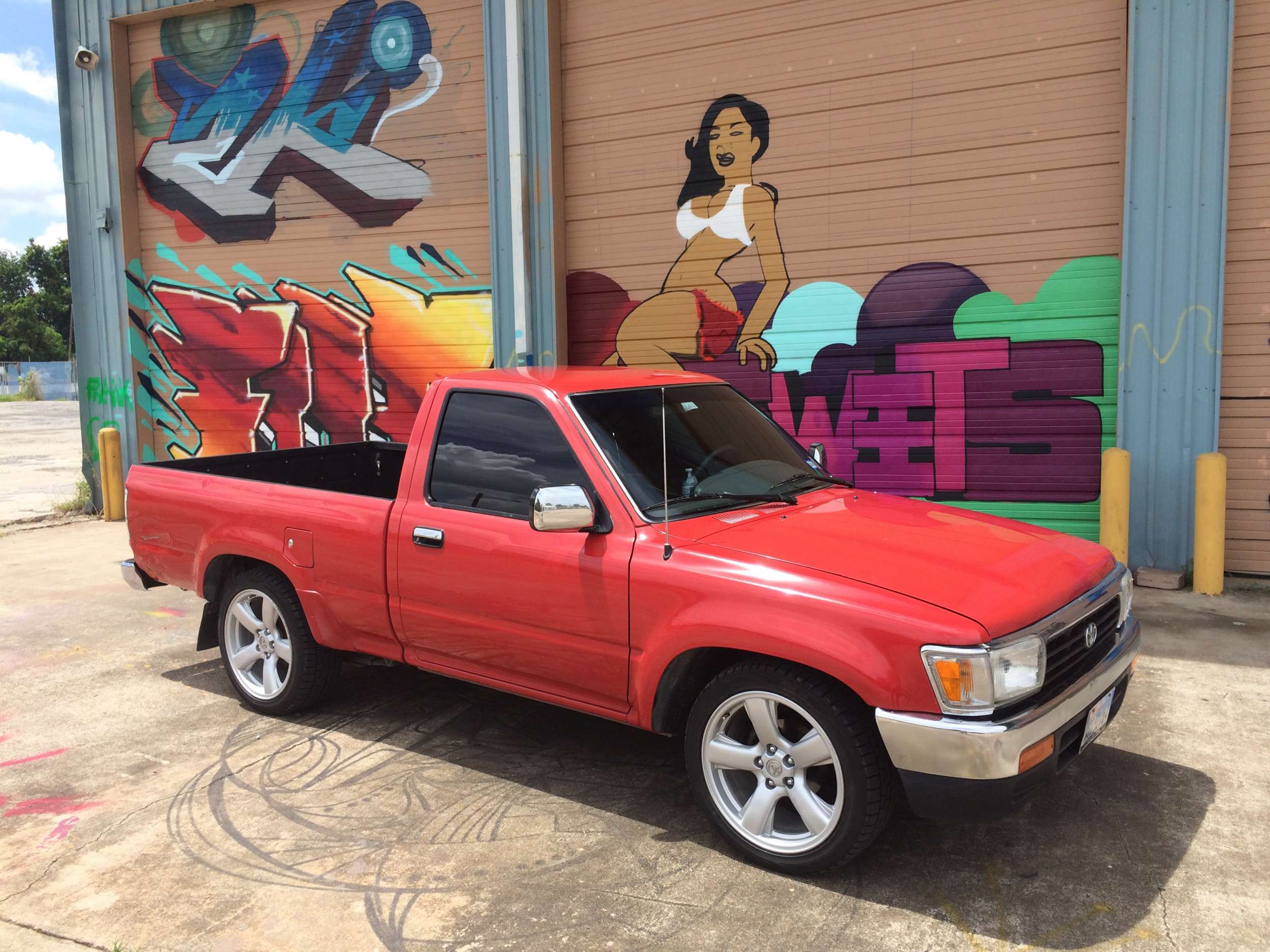

I liked the Steelies I had on but always felt since it was 2WD I should make it look more like a street truck. I like original wheels and looked for over a year for some X-Runner wheels. Personally I think the Hilux's look better with these rims than the X-Runners. Lol. No drop just slapped them on. They were already bored when I got them. 67.1 is what you need. They come 60.1. To get the center caps on the front to fit you just take off the hub bore cover.
